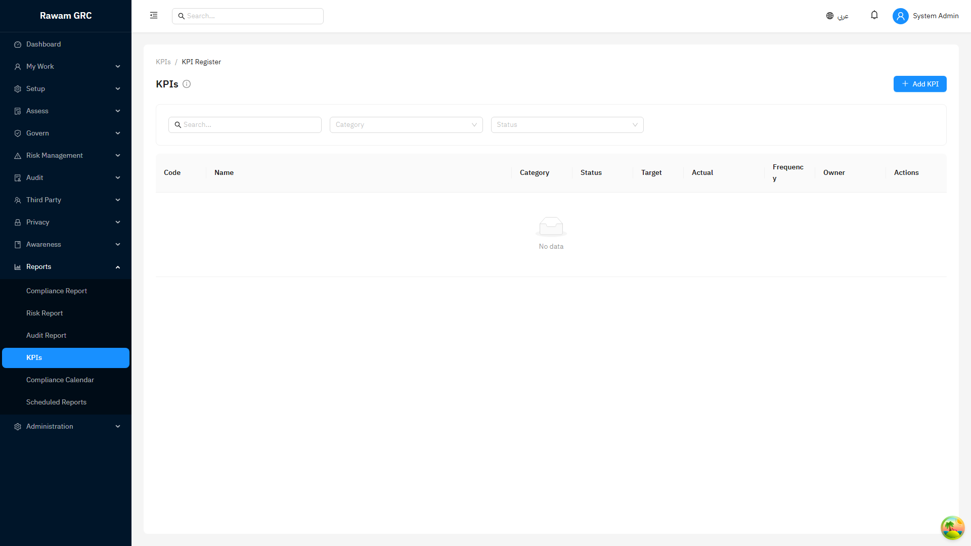

7. KPI and Metrics Workflow
- Open KPIs & Metrics.
- Review KPI cards by category: Risk, Compliance, Security, and Operational.
- Check the current value, target, threshold status, and latest measurement date.
- Investigate any KPI marked At Risk or Critical.
- Open the source module to understand which records caused the KPI value.
- Assign an issue or remediation task when the KPI requires action.
- Review thresholds periodically to confirm they still match management appetite.

15. Screenshots
Dashboard
KPIs
