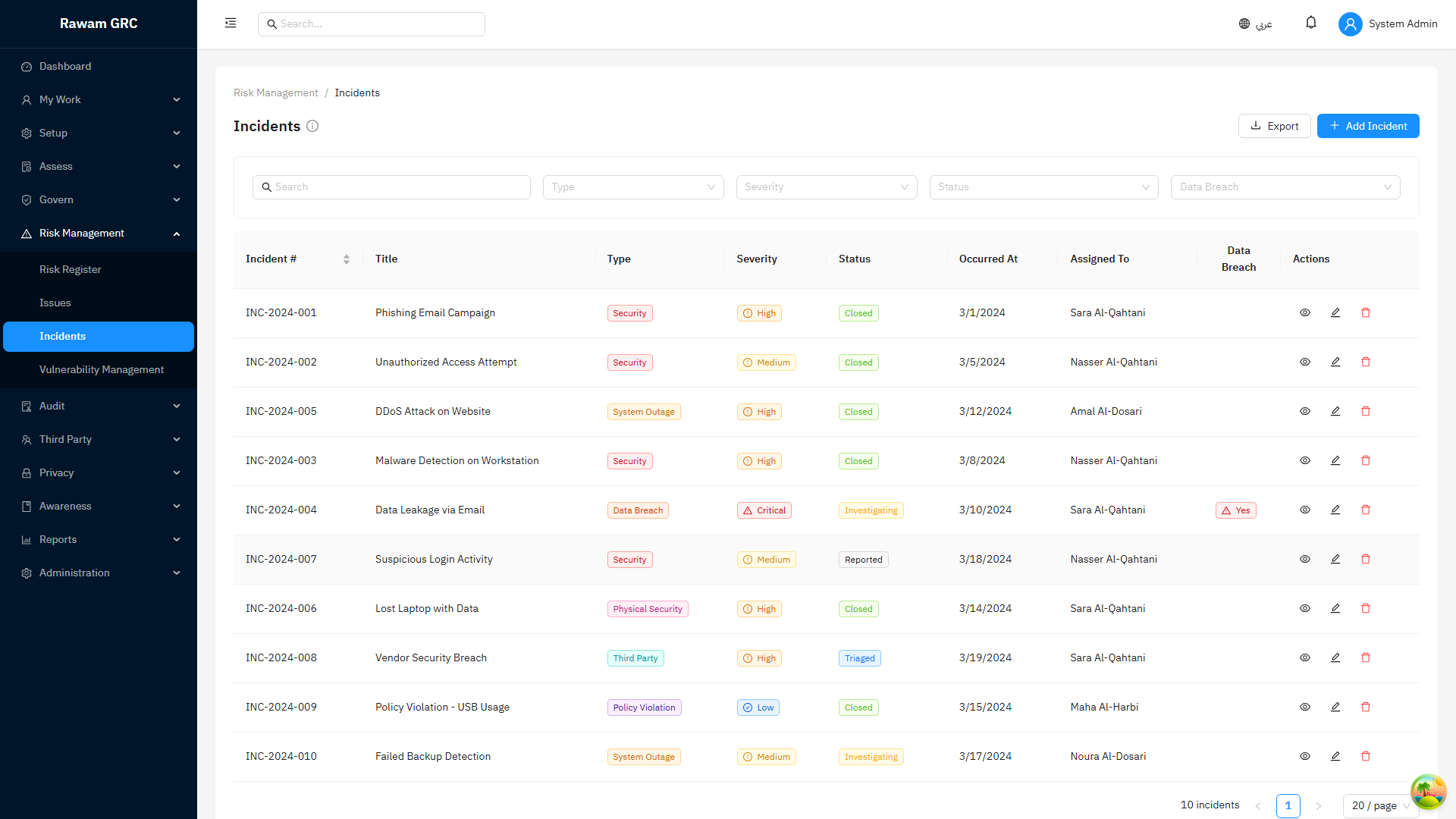

4. Incident Flow
- Open Incidents.
- Click Create Incident.
- Enter title, type, severity, affected asset/vendor/user/process, date, and description.
- Assign incident manager and owner.
- Record containment, investigation, root cause, and impact.
- Link related risks, assets, third parties, privacy records, or policies.
- Create actions for remediation.
- Review and close when response and evidence are complete.
Incident statuses:
| Status | Meaning |
| Reported | Incident logged but not yet triaged. |
| Triaged | Severity, owner, and scope have been confirmed. |
| Investigating | Root cause and impact are under review. |
| Containment | Immediate impact is being controlled. |
| Eradication | The cause is being removed from affected systems. |
| Recovery | Normal operations are being restored. |
| PostIncident | Lessons learned, follow-up actions, and documentation are being completed. |
| Closed | Incident is resolved and documented. |

15. Administrator Checklist
- Require owner and due date for actionable issues.
- Use severity/priority consistently.
- Link issues to source module records.
- Review overdue issues and actions weekly.
- Link incidents to affected assets/vendors where applicable.
- Create risks for material incidents or recurring issues.
- Do not close issues without evidence or reviewer confirmation.
